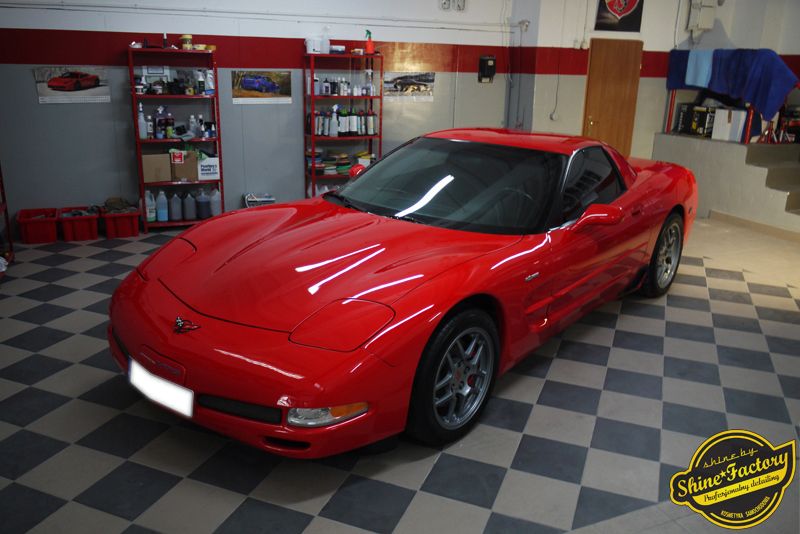

Na dworze wyglądał pięknie.
http://i1082.photobucket.com/albums/...2/P1250367.jpg
http://i1082.photobucket.com/albums/...2/P1250368.jpg
http://i1082.photobucket.com/albums/...2/P1250370.jpg
http://i1082.photobucket.com/albums/...2/P1250371.jpg
http://i1082.photobucket.com/albums/...2/P1250372.jpg
http://i1082.photobucket.com/albums/...2/P1250373.jpg
http://i1082.photobucket.com/albums/...2/P1250375.jpg
