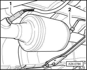

18635/P2203 https://translate.google.pl/translat...ml&prev=search
NOx Sensor Bank 1 przed katalizatorem nr.1
http://workshop-manuals.com/audi/a3_...es/a3-1871.png
